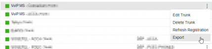

I've just been asked to setup a 3CX PBX for a customer, it's my first one on V20 and I can't find anywhere to change the "CalledNum" to use "Request line URI : User Part" like I could for inbound calls on V18. I assume this is another missing feature of V20, are there plans to implement this back in? I'll be unable to use registration trunks if not.
You can "export" the trunk, edit and reimport the XML file.
