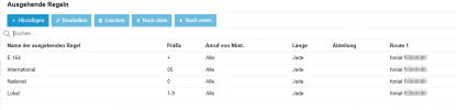

This are my rules and everything is working just fine: 1724232498318.png

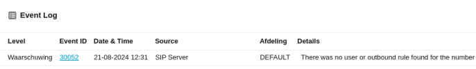

I tried replicating this, but I experience the same issue. On my test 3CX there is only 1 outbound rule, with no department defined, any prefix, all extensions, but when I try to call from my system owner extension, which is in DEFAULT group, 3CX gives the error that there was no outbound rule found. Are you sure that you don't need to define the department in the outbound rules?

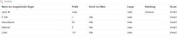

Edit #1: I tried again... I need to put the department in there but no caller id. Without department it takes the second rule.
Edit #2:I think since update 3 you need one part of the configuration.. Präfix, extension or departmen... Could this be possible? @JohnS_3CX
Edit #3:Now its clear for me... Sure you need one thing to match your rule.
This one should work for a catch all: 1724239235270.png
