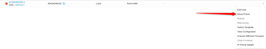

@Alphabetic this option is available on U10. Check the blog here.
You can do on the Admin Console >> Phones, find the deskphone model that is assigned to an extension. Go on the right side on the 3 dots and select " Move Phone ".
A popup will come up and this will gve you the option to select the extension you want to assign it to.
Select the extension and click OK. Thats it.
