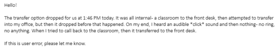

I am trying to troubleshoot a problem I can't even isolate between the phone, pbx, and sip vendor. I have opened a ticket with sip vendor about dropped calls. Though I think this has to do with the phones and/or 3cx pbx. I have 2 centers in different suburbs and using 3cx ent/ai for 8c calls with 2 DIDs from a telco. This phone system was hosted and managed by a different vendor including telco without issues until 3/2026 when I switched to 3cx (had to change due to cost, they were good :D). I admit I don't understand pbx as much as I need to. Thanks to the community I was able to resolve all my previous problems. The one persisting issue is random garbled audio, dropped calls, and phone dropping connection to the pbx. Please keep in mind, these used to work without issues for both sites pre-3cx switch. Both networks are different, verizon and cox. All the phones are Yealink and only 3 are not T46U. Please help me identify where to look for the problem. Thank you.

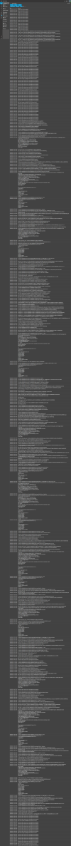

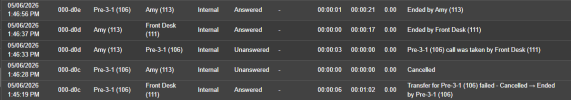

I called the center, she can hear me clear, but I from my end I it's not as clear. The "details" from below regarding RTCP doesn't look good. hard to say it's the firewall since didn't have any issues with call quality with the last provider. Both network configured differently with different ISP and routers, yet both having the same issues.
