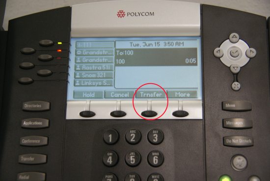

- Press the “Trnsfer” soft key.

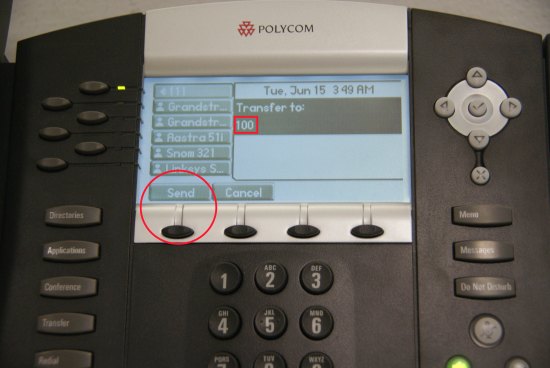

- Press the "Blind" soft key and dial the extension number of the person you would like to transfer the call to. Press the "Send" soft key.

- Press the “Trnsfer” soft key to start the attended transfer procedure. This will automatically put the caller on hold. Dial the extension number of the person you would like to transfer the call.
- Press “Send” to call.

- Press the “Trnsfer” soft key to transfer the call.

TIP: You can also press the line key at the top left of the above screenshot to inform the caller that you are about to transfer the call to the end destination.
