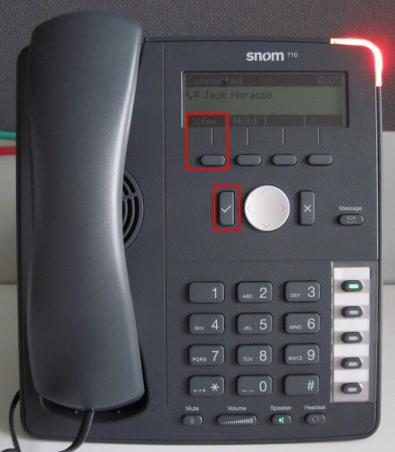

Blind Transfer Method
- Press "OK" (check mark) to answer an incoming call.
- Press the "Xfer" soft key to start the blind transfer procedure. Dial the extension number of the person you would like to transfer the call to. Press "OK".
The the call has been transfered to the specified extension.

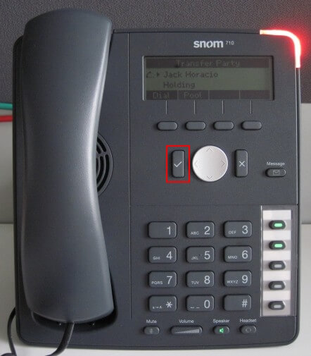

Attended Transfer Method
- While on call, press "Line 2" to initiate a new call. This will automatically put the caller on hold.
- Dial the extension number of the person you would like to transfer the call. Press "OK".
- The transfer recipient answers and accepts to take the call.
- Press the "Xfer" soft key followed by "OK".
- The call from Line 1 and Line 2 are now merged.
