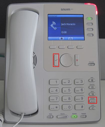

Blind Transfer Method
- Press "OK" (check mark) to answer an incoming call.
- Press "Transfer" and dial the extension number of the person you would like to transfer the call to. Press "OK".
- The call has been transferred to the specified extension.
Attended Transfer Procedure
- Press the "Hold" button and dial the extension number of the person you would like to transfer the call to. Press "OK".
- The transfer recipient answers and accepts to take the call.
- Press the "Transfer" button followed by "OK".
- The original caller and the transfer recipient are now connected.
