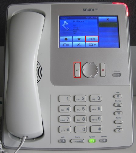

- Press "OK" (check mark) to answer an incoming call.
- Tap
on the touchscreen and dial the extension number of the person you would like to transfer the call to. Press "OK".
- The the call has been transferred to the specified extension.

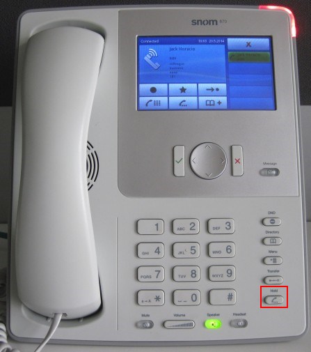

- Press the "Hold" button and dial the extension number of the person you would like to transfer the call to. Press "OK".

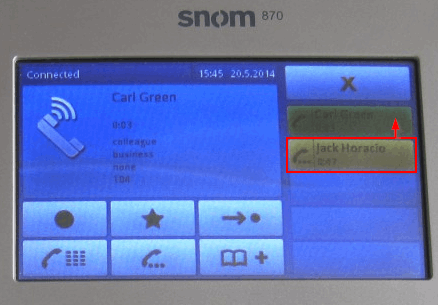

- Tap and drag the "on hold" line to the active call to transfer the call.
- The two calls are now merged.
