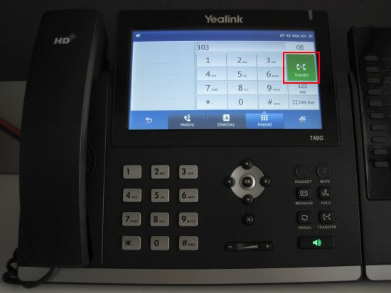

- Press the "Transfer" button on the touch screen, enter the extension number of the person you would like to transfer the call to. Press "Transfer".
- The the call has been transferred to the specified extension.

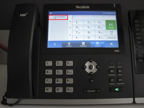

- Put the caller on hold by pressing the "Hold" button on the touch screen.

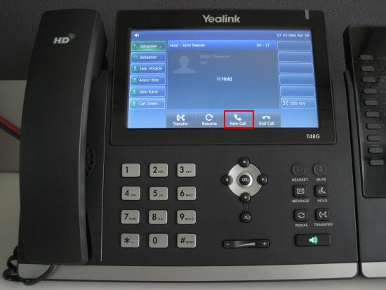

- Press the "New Call" button to initiate a new call. Dial the extension number of the person you would like to transfer the call to. Press "Send".
