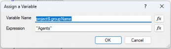

To the right, if you double-click on Comp_ChangeStatus.comp,
you can modify the first two variables (string).
The first is the department name.
We will ignore any extensions that are not at least part of the department configured in this variable.

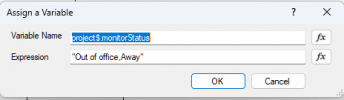

The second is the name of the statuses that are forbidden to use. If any of the extensions has one of the statuses written in this variable (separated by a comma), it will be considered in the wrong status and will be added to the list of extensions where an intervention will be made.
If the extension has a status that is not on the list, which you can customize in the variable, we ignore it; no intervention will be made (In my example, Available, Custom 1 and Custom 2 are statuses that we ignore; an extension having one of these statuses will be ignored).
You need to use the status names as seen by the system, not those displayed in the graphical interface.
Available
Away
Out of office
Custom 1
Custom 2
If there are several, please separate them with commas.
