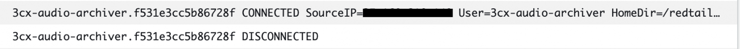

Can anyone shed light as to why my audio archiving is failing? I am using AWS Transfer Family service, and have a SFTP server setup there with a user created that is setup with permissions to a specific bucket where I want those recordings to end up. I tested the connection to the bucket using WinSCP and was able to connect no problem and uploaded a file. However, when I use the exact same settings inside of 3CX, I don't get the same results. I checked the logs on the SFTP server and it shows a quick (I'm talking 1-2 seconds) connection and then it disconnects with no actions in between. Has anyone set this up to have their audio recordings archive to s3 before, or know what I, or the SFTP client in 3CX is doing wrong?

Below is the log that I am seeing inside of AWS:

Yeah I have tried with the trailing slash, and I am still getting that same result. I did find this in the 3CX management console log:
2021/01/14 09:23:42.116|13522|0021|Exc|Renci.SshNet.Common.SshException: Cannot open file in mode: CREATE|EXCLUSIVE|READ|WRITE
at Renci.SshNet.Sftp.SftpSession.RequestOpen(String path, Flags flags, Boolean nullOnError)
at Renci.SshNet.Sftp.SftpFileStream..ctor(ISftpSession session, String path, FileMode mode, FileAccess access, Int32 bufferSize)
at Renci.SshNet.SftpClient.Create(String path)
at _3cxFilesystemImplementations.SFTP.SftpFolder.CreateFile(String name)
at TcxRecordings.RecordingData.Archive()
at ManagementConsoleJS.Controllers.RecordingListController.<>c__DisplayClass19_0.<<Archive>b__0>d.MoveNext()
I'm just beginning to wonder if maybe the SFTP client 3cx uses wont work with the server I have setup in AWS.
SFTP works using the SSH protocol and instructions, so unlikely.
I can't say for sure, but so far every time I have looked deeper into such a case, it has always come down to permissions.
Basically what 3CX tries to do is once connected, check if it has permissions, as implied by the Exception you found.
Have you tried it against another Linux machine to test this theory?
