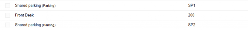

have you assigned the department any call parking spaces? Go into the department and then click add, and find the shared parking and add.
Yes, I assigned that department SP1 and SP2

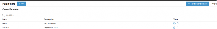

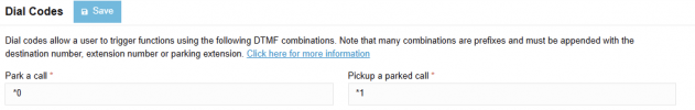

Have you checked in parameters and type in call park, and see if the dial code is showing what you are expecting to see?
2025-05-06-10_27_26-parameters-3cx-png.47747
2025-05-06 10_27_26-Parameters - 3CX.png2025-05-06 10_27_39-Dial Codes - 3CX.png2025-05-06 10_28_37-Admin Console - 3CX.png
From what I am seeing the parameters and the dial codes both seem to line up. And I did add Sp1 and SP2 to my department
