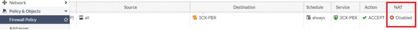

Hello, @JohnS_3CX as you said it was NAT configuration. Aftter changing NAT setting in FortiGate Firewall Policy to Disabled everything works fine. Small but important detail. It is strange because it worked before without this setting.
