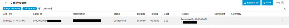

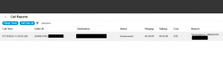

Any idea on why a rule of UNKNOWN* would not block calls with a CID of "UNKNOWN (+DIDNUMBER)"?
My other CID rules are working, generating a busy signal and a reason of "Route busy" in the Call Log report.

Still not working.
Set the CID rules with a space like "UNKNOWN *" and check again please.
  • Sad
Reactions: NCIA and jed
Changing the rule to add a space "UNKNOWN *" ended up blocking all incoming calls to our PBX.
