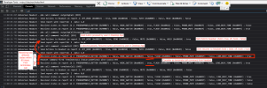

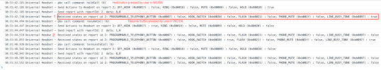

For those interested in this, here you can clearly see the difference between the two jabra models. That is why it works for Jabra 935 and not Jabra 930. We are hesitant to change anything because other models might be effected. So we are awaiting Jabra response. This is really something that a headset provider needs to test and support themselves.

Thanks for your screenshots:cool:, I have also forwarded them to Jabra.
