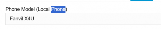

Hi Kyria
Thanks for the quick rely, its showing as "Local Phone" (Screenshot attached)
I am the system owner for all the departments as well as the whole system, and when I add the phones/extensions I use my own login.
When I add new phone, it didn't give me option to set this as router phone. Can you help, I will delete this and re-add perhaps that may be the issue. Previously when I added this phone, it only gave me option to set this as local phone, connecting to server via FQDN or IP address of the server, but no where is there an option to say this is "Router Phone"

After you enter the basics (in Users->Edit User xxxx-> IP Phone-->Configure a Phone):
You should be getting this, that sets it as a router phone.
Hi Kryia,
Thanks for the reply, I checked this and noticed that I had selected "Fanvil X4U" not "Fanvil X4U-V2", I then deleted the phone and recreated it selecting the correct version. The phone now shows successfully connected on the extension, but "Router Phone - SBC" connection shows "Red" on the "Voice&Chat" tab
Any idea why this is happening
Might need some time, usually not long - also do check that you do not have some firewall in the middle blocking the relevan SBC port. Sometimes a restart of the phone after it got properly provisioned is needed, although most phone do that themselves.
