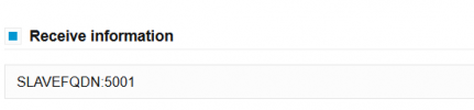

I wasn't able to use 443 on the slave network as it is already routed to a web server machine. However, I configured my router to make port 5001 available publicly available, forwarding it to port 443 on the slave 3cx machine (192.168.2.27), i.e. 1747929442891.png
I then changed the bridge 'presence' page on the master 3cx, to include port 5001 - i.e.
Subsquently presence information became available on both systems!
