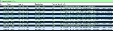

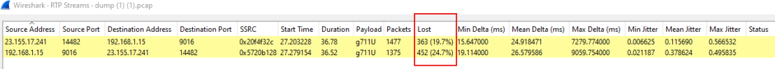

We are having major problems with our 3CX pbx. You can connect a call but within 10-20 seconds the app indicates recovering and get the double beep - all audio dropped. it will recover after another 10 seconds. We are self hosting. I had Fortinet on the phone for hours and eliminated a few things but could not solve the problem. This is out of the blue, no changes have been made to our network or pbx. Any suggestions as where to look?

This is network related issue as something is blocking packets.
Any ideas on how to troubleshoot this? I've had Fortigate look at it and they feel like the PBX is the issue.
The screenshots show that this is on both direction from/to the PBX therefore this has to be checked on the local network or the NIC of the machine.
