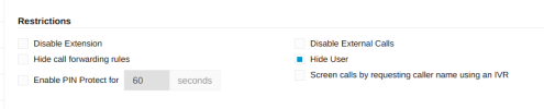

@itwork13 for the Teams, does user 1011 have the option " Hide User " enabled ?

Users 1011 and 1029 have the Manager role, but I cannot open their profiles to check whether the “Hide User” option is enabled because they are completely missing from the Users page.
They only appear under Departments → DEFAULT, but their entries are not clickable or editable.
How can I access their settings to disable “Hide User” if they are not visible in the Users list?
