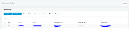

I noticed the screenshot you provided is from the SIP Trunk configuration, do you happen to have any inbound rules that may be matching this inbound call instead?

do you mean this by inbound calls (attatched a picture)? or did you mean a configured CID rule?

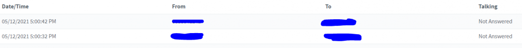

What leejor said was tested. Calls show up as not answered (2nd picture added is the one from the calls log).

What log (3CX Activity Log) do you get back, from your provider, when the call is sent to them?
Perhaps compare that type of call (one that is failing), with a log of a call to the same number, dialled direct from an extension. What is different? Sent number, perhaps caller ID?
do you mean this by inbound calls (attached a picture)? or did you mean a configured CID rule?
He means both, regardless if it's a DID or CID Rule, there might be a rule matching that same call and therefore using different routing. Though if you see a call log entry to the mobile number you have set then it means you are probably not matching a different rule. I would first simply try and make an outbound call to this mobile number from one of the 3CX's extensions (even during office hours) to first ensure that calls to the number in question do go through. When dialing the mobile number, make sure you use the same exact number formatting you have used on the Inbound Rule/SIP Trunk routing.
If this call works, there's a good chance the issue is related to Outbound Rules restrictions. If this is the case, try creating an open Outbound Rule with a prefix value of +,0-9 and absolutely nothing else. Move this Outbound Rule to the top and then wait for out of office hours to test your scenario again.
