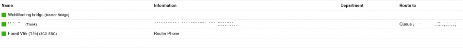

Thanks, I selected reprovision on it and it dropped out of 3CX so asked them to reboot it and they got the IP conflict so was going to try and find the conflicting device on the network.There was another SBC not showing in the screenshot that was on a server that is now decommissioned so looking at deleting that one in case it might be causing issues although showing as red so assuming not if it's offline?

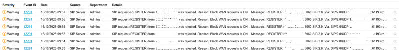

Thanks, looking into the IP conflict at the moment to see what the other device is. Still getting the below come through for that extension (111), unsure if any of the content is helpful to troubleshoot further at all?
I'll look at upgrading the firmware on the Fanvil V65
Sorry the SBC is on the latest version, I read the last one (18) from the Voice & Chat screen going into the SBC
This is an indication of the problem, the Polycom VVX411 of user 111.
I do not think this is related to an IP conflict.
1. Factory reset it so it will stop trying to register incessantly.
2. Delete it from the user 111 and add it again, make sure this time you add it "Connect via SBC" and choose the SBC you want to use. Guide: https://www.3cx.com/sip-phones/polycom-vvx/
3. Do no forget to enable blocking of the non tunnel connections again, do not leave your account vulnerable.
This way the next time the phone registers, it will be via the SBC. You might want to DHCP-reserve the IP address of the SBC device, so that phones will always find a path to the PBX.

I would also add that maybe you can zero in on it from the Event Log message.
REGISTER FROM = Your public IP behind which this phone is making the registration attempt - confirm its from that office indeed.
VIA = The local IP of the device making the attempt (hopefully accurate, since you had conflicts you said). This should be a local IP, conforming to RFC1918 addressing, and using the private range NOT the public range.
