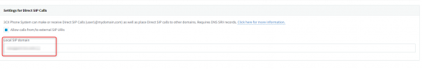

A fast workaround is to set SIPDOMAIN2 (Settings -> Paramaters) to something that is not FQDN.
Doing this will break communication with the 3cx mobile apps!
Suggest using Split DNS if the system was installed using a single external FQDN.
Or if you chose the public IP during the installation instead of the private IP to re-deploy the system, take a backup and test it during the redeployment, then use the private IP instead, but note that in the future release of 3CX Split DNS will be enforced.
That is not true, this doesn't affect mobile apps at all, neither previously nor currently provisioned mobile apps.
Are you referring to changing the the section below
No, I'm referring to the exact parameter I mentioned in my post.
Settings -> Parameters -> variable SIPDOMAIN2
