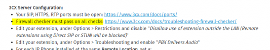

You mentioned you had seen the article I linked but nothing helped but the firewall check is a necessary step there:
That particular router appears to have phone ports. Usually for those type they have a SIP ALG backed in and/or have 5060 blocked because it's intended for service providers to deliver phone service to. So if you can replace the router, great but otherwise you'll have to go hosted or only work with configurations that don't need 5060 like webclient, soft phones or SBC based desk phones.

From the error message, your firewall is not doing port preservation. It is remapping the source ports.
Please consider reading the guide at: https://www.3cx.com/docs/firewall-checker/
The firewall check does NOT lie!
