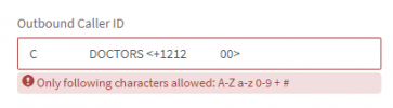

Previously, in version 16, the Outbound Caller ID would be set by 15CHARACTERNAME<+17663686237>, but now, after upgrading to version 18, it will not allow the "<" or ">" characters. Rules that already have the "<" and ">" characters from version 16 still work, but if you open them to edit, it will not allow you to save, even if you make no changes.
If the caller ID is entered without the "<" and ">", it is ignored by 3CX
This is a bug, but I don't want to use a ticket just to report it.
This change was actually implemented on purpose hence the message you see underneath the field that states what characters are allowed. Your current values did not get removed but you won't be able to edit or add new ones as you have already noticed.

We support 9 different Divisions, each with their own CNAM and number. There are specific Outbound Rules setup with these names and numbers for each Division. I can set the Outbound caller ID number on the user extension, but I don't want the individual callers' names showing up with the number. It should be "DIVISION'S NAME"<+17663686237>, just like how it worked in version 16 and before and with all other PBX systems I've ever used. The fact that it still works with the Outbound Rules that were migrated, shows that the capability is still there.

To clarify, what changed on the 3CX end from v16 to 18 is the Caller ID validation. That said, 3CX will send whatever value the field holds so if that is not presented as expected then it means that it's probably one of the SIP Providers or the receiving end modifying the CID.
The validation is the problem. It no longer allows the angle brackets which separate the name from the number. without it, most providers ignore the caller ID, because it's over 15 characters. The ones that accept it, ignore the beginning of the string and just send the number.
I think the part you're ignoring is that it currently works (and is properly formatted) with the angle brackets on the routes that were migrated from v16. The fact that it only throws up an error when those routes are edited or new ones with that specific format are added, shows that it's an issue with the code. If I could revert to v16, I would, just for this reason alone.
I can confirm this is by no means an issue in the code, as mentioned earlier this change was implemented intentionally, the fact that it does not automatically invalidate your existing configuration is only due to the fact that the validation check occurs upon saving the configuration.
But why? Why remove functionality? Why the regression?
Evidently certain values in the Caller Id will cause issues with a number of SIP Providers so some restrictions had to be imposed to avoid misconfiguration and maintain functionality. Plus, none of 3CX's Supported Providers actually require such configuration to work as intended.

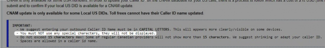

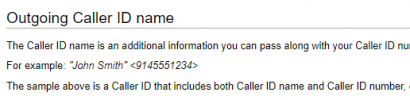

I believe that by Caller ID name voip.ms is referring to the "From: Display Name" which is part of the Caller ID header in a SIP Invite:
Red is the "From Display name" (Caller ID Name) and Blue is the "From User Part" (Caller ID number). The way the 3CX Voip.ms template is set up will have both these fields populated with the Outbound Caller ID value you specify. That said, you would end up with something like this in the SIP From header:
From: "DIVISIONSNAME<123456789>"<sip: DIVISIONSNAME<123456789>@hostpart>
Needless to say, the above format is completely invalid and also violates some of voip.ms requirements mentioned in the same link you provided:
Taking the above into consideration, the only way this could perhaps work is if you had modified 3CX's SIP Trunk configuration for the specific provider hence deviating from the default settings and ultimately rendering the said SIP Trunk configuration an unsupported configuration.
In any case, even if this was valid, as per your post Voip.ms clearly states it is an additional option that CAN be used:
Therefore my statement that this is not a requirement still stands.
