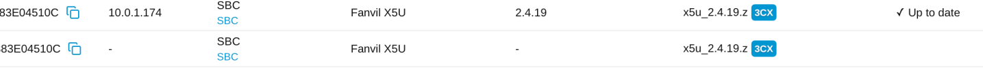

I am running a hosted 3CX system with a SBC and have a Fanvil 5XU running 2.4.19 that has worked fine without issue that is suddenly showing the phone off line on my administrative console [red square on the listed phone page]. The phone works fine and can send/receive calls and I have rebooted, etc, not sure if to ignore or something is going on. This is new after 2 years without issue on this particular phone.
Only thing that has changed was I updated the Debian on my NUC SBC about 2 months ago.

I have one other Fanvil X7 that also started doing this a few days ago a few times
All phones are configured with the default template [no modification/custom].
How can I tell if the phone is registered under Admin>Users? I have not reprovisioned yet.
Running 20.0 update 10
Not updated to Trixie, I just wiped the SBC and updated to 12 because I was on 10 I believe.
Chat also shows both phones online
I tried to reprovision the one phone. I select it and the reprovision button is unable to be pressed. I manually rebooted the phone and now the phone shows up twice in the phone list as a duplicate, one is online and one is offline.

I deleted the duplicate but am not sure what is going on here.
Thanks. All online now. Will see if it comes up again.
