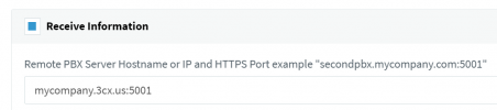

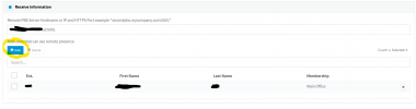

When using a bridge, add users, otherwise none will show.

In the SIP Trunks -> Presence tab, we changed the Remote PBX Server from IP to FQDN on each device / SIP trunk.
