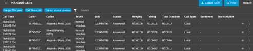

Hi @NJohnson did you check the inbound calls report?
You can get the inbound calls on the specific trunk and DIDs.
I see that and it's helpful, but that's more of a call log report. What I'm looking for is something that shows the total number of calls broken down by answered/unanswered calls over the given date/time range for specific DID(s). I think it was called "Inbound Statistics Report" in V18. The way we have things configured is that each of our stores is a department in 3cx and each of the store's main DID gets routed to their own auto attendant where the caller can select which department of that store they want to go to and then it's routed to the appropriate call queue or ring group. So in the past (V18) when a store manager would ask for a report for last month's total calls broken down by their departments, I would send them the inbound statistics report for their DID and then send them the call queue statistics report containing all their call queues. I can still get them the call queue statistics no problem. It's just the total # of calls for their store that I'm struggling with. Also, I should mention that not all auto attendant options go to a call queue/ring group (but most do). Some go to a individual, which makes it harder if I can't get a total based on DID.
