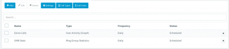

We have a customer that wanted some basic reports daily so I scheduled them to run nightly at 7 PM. Tonight was the first night it ran and it did so as scheduled. For some reason it ran again 2 hours later and has ran every few minutes since. I will probably delete the scheduled reports to make it stop but not sure why it is doing this.

Hi @jcostlow,
Were the reports made on v16 then you upgraded to v18?
If you delete them and recreate them, do they still repeat?
If it continues to duplicate reports, have you tried restarting services?
Hi @VasilisV_3CX
The reports were made recently and we have been on v18 for a while now.
I deleted the reports to stop them from running so I will recreate to see if it happens again.
I have deleted the scheduled reports and re-added. It did it again last night.
Reports ran at 7 as scheduled and then 2 hours later started running every few minutes until 2:38 this morning. I just restarted all services.
