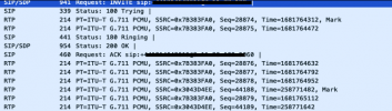

Did a Wireshark and I am not too sure how to see which devices are ringing, all I can see is this:
But this trace is for the Ring Group where both phones rang, but it only shows on 180 message as Ringing - should it not show both??

So how would I determine what devices are ringing in a Wireshark trace? as the above doesnt show it :(

If the clients work as expected, then it becomes more likely that your phones might have been the problem. At this stage, wireshark can be used to see what the PBX sends (does it ring each extension? and what did each phone reply to the invite? etc).
