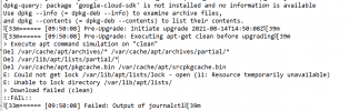

That one provided me the following error which appears to be a lock file that could be cleared on a PBX reboot. Please provide input. Here is the relevant log excerpt.

@Felicia King That part of the log doesn't say much as failing at the beginning, middle or end of an upgrade makes huge difference. If the system is still operating and running V16 that means it must have failed early before upgrading to Buster. In any case, the best and safer solution would be to deploy a new clean V18 instance and restore from backup (or restore that machine at a pre-upgrade state and retry)

As the log indicates there was a problem with the key being used by those repositories to sign its packages. Even though this is an issue that breaks the upgrade, the script detected it and restored 3CX to V16. So even though the upgrade failed, your 3CX system should be operational. This gives you time to migrate to your new instance.

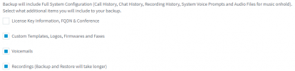

1. Take a full backup of your 3CX installation and download it
2. Shut down the old VM
3. In the Customer Portal click Reinstall and follow the steps
4. Login into your new instance and upgrade to V18
6. Restore from backup via the Management Console
Regarding your second point, I am afraid this is currently not possible. If you need a "test" installation which will be running along with the production one, you'll also need another key with another FQDN. In that case you can take a backup without License key information and restore it to the instance you will deploy for your secondary key (for which you will select a new FQDN during setup).
