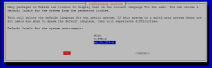

Hi @RossFS,
It seems that system locales haven't been set up properly.
SSH on the system, run the following command and follow the steps (it is only two screens/steps)
Bash:
sudo dpkg-reconfigure locales
Make sure you select the correct locale and also make sure you select a default locale (in the second step)
Example:
Then reboot and try upgrading again.
