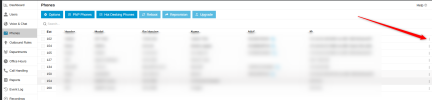

@robert.sadler@bithappens. when you update a BLF on the PBX, this means that the config file for the phones is updated.
You can check this with the 3 dots >> config as per the screenshot below.
This will show you what the config for that particular phones is.
Example I have updated my 6th BLF to SP0.
In the config file it will show like this : linekey.6.value = SP0
Then you will have to see if the phones can reach the PBX via https to get the new
config file and if they get it, why they dont apply it.
