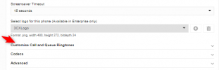

Navigate to the user's settings in the admin console, and from the IP phone section, expand the option near the bottom of the page for the 'Customise Call and Queue Ringtones' and you will see the the section 'Ringtone per Queue'.
If you dont see the cusotm ring tones option for the queues then under the phones node >options tab you can enalbe the option 'Use custom ringtones per queues'.

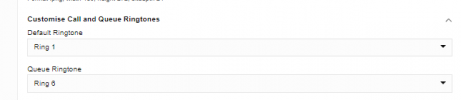

I'm just doing my first v20 and noticing in phone provisioning, there is no longer Configure queue ringtone. We have always set Default ringtone and Queue ringtone. Not looking to customize for each queue but clients have had a different tone for queues up to now. This is very important to them. Please bring setting default queue ringtone that can be different from the default ringtone when not on enterprise and not needing different ringtone for each queue.
@bbaker73 Hi there.
Its actually the same in V20, so in you go to the users, and IP Phone tab, and scroll down, you will see the category "Customize call and Queue ring tones"
expand it and the Default Ringtone option is there
Ah, thanks for your response @OlegR_3CX. I looked further and found that on v18, this pbx had Use custom ringtones per que set in the phone/app options. It is a pro system, not enterprise but I believe this is a feature was available to pro prior to v20. Perhaps on v20, this should not be selectable with verbiage (enterprise only) on this screen.
Thanks Again! :)
This option is available in PRO editions:

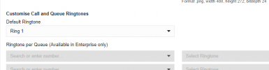

@TheodorosG_3CX I sincerely apologize if I'm missing something. This is my first v20 upgrade so I'm looking to see what is different before deploying to other instances. This is a 4 SC Pro License. If I select use custom ringtones per queue, as in your image, on the Users, IP phone provisioning tab, Queue Ringtone field is replaced with Ringtone per Queue (Available in Enterprise Only)
@bbaker73
Apologise for the confusion and misunderstanding here.
So, the ringtone, per specific Queue (once you enable the option shown above), is indeed an option for the Enterprise edition.
With normal settings, you can only change a Different single ringtone for all the queues.
