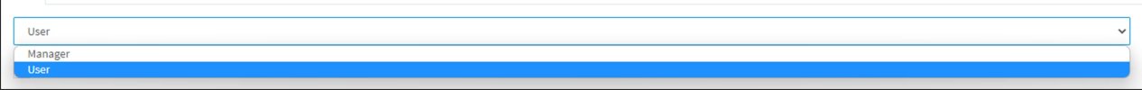

Hi All,
Little question about the ''System Owner" rights. When i logged in to the management console as a admin (i'am logged in with the user what is set up in the Root Credentials section). I want to make a user and give him the system owner rights, only i can't see the options becaus it is not available. The only options i get is the "User" rights and "Manager" rights.
Does someone know what i am doing wrong or can cause this problem?

Hi All,
If you are logged in as the root admin (ie. the user that does not have an extension number) you should be able to do this. Are you certain that this is the correct login? (Try it with Google Chrome)
Reactions: Kevin vd Wegen
Hi John,
Thank you for your reply, i already use Chrome. (tried with Edge and got the same problem)
I did it also for other customers wit no problems.. Also i'm positively sure that these are the right credentials, i already reset the password of the root account.
Is there anything else i can check?
