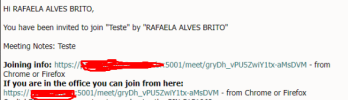

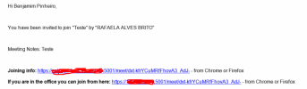

After my update to 6, the conference e-mail sends links different between organizator and participants.
The link of the participants it's correct when access in my office, link number 2, and external, link number 1.
The link of the organizator not is the same. When I access in my office, the access it doesn't work, and then, it redirect to external link, but the access is internal.
E-mail to participants
E-mail to organizator
The organizer is supposed to have their own link because "meeting starts once organizer joins" is the default setting for video meetings. I'm not sure I understand what isn't working...define "doesn't work"?
