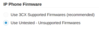

You can already uploaded untested firmware directly from the interface

The one exception that you need to keep in mind for all phones regardless of model, is if your firmware happens to be too old and the phone itself refuses to upgrade. We do also provide this option, so you can easily install your interim firmware, then switch back to supported and install the latest 3CX certified FW.
