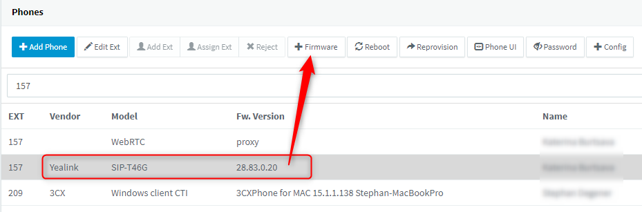

This can be done easily from within the 3CX Management Console from the “Phones” section. Select Yealink IP phones which show this current firmware version.

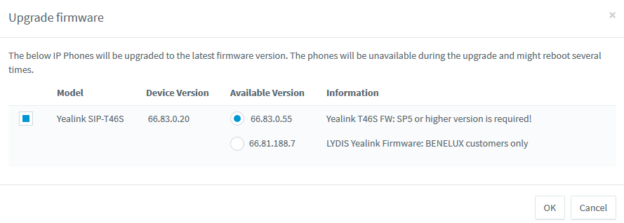

Press the “+ Firmware” button and select the new Firmware.
If the new firmware is not automatically shown use the PBX update function to pull the latest firmware.
Important: If you do not update your XX.83.0.20 firmware to XX.83.0.55 and a newer version is released in the meantime then you will have to update all your devices manually via the device’s web interface!
