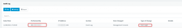

The auditing does not show which user via SSO signed in to MGMT console admin - is this due to be improved?
@mcoacollins Thank you for explaining the use case - definitely makes sense of course. If the app supports it - and you are right it might do as an electron app - then of course we will add this functionality. We plan to make some additional features in update 1. If you have issues with the v16 windows client let us know.
It's not currently planned, but as an alternative, you could grant individual Users/Extensions with Rights to log into the Management Console, so that not everyone uses the "admin" account.
That then will show up in the Audit Log.

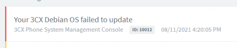

Private hosted on Digital Ocean. Is there a log I can view with more details? Currently running 16.0.9. Hoping it's something simple so we can update a bunch of our instances there...
Please try again, our team identified a configuration that needed updating in a specific zone.
Yep, fixed thankyou for the Sydney servers. I've had a conference running for several hours today without issue. Thank you for your response and the fix.
If you haven't rebooted your machine since the failed update attempt, there should be a file /tmp/UPDATE.log that you can check for more details.
