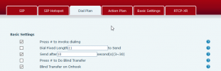

Fanvil X4U not Blind Transfer on Onhook,
Option is enabled in the default supported template and latest firmware, and double checked by logging in, also enabled on phone for certain.
Trans > BLF/EXT > Hangup.
What it is doing is instead of transfering, it is hanging up and placing the original call on hold.
However, there is one phone out of three here that is working as intended. All phones are behind the same switch and SBC.
Temporary fix is to enable,
XML:
<Onhook_to_AXfer>1</Onhook_to_AXfer>
and,
XML:
<CallSemiXfer>1</CallSemiXfer>

It is running the supported firmware, something else to note, plug and play "adoption" was not working either. I've setup over 300 phones and this group something is off.
