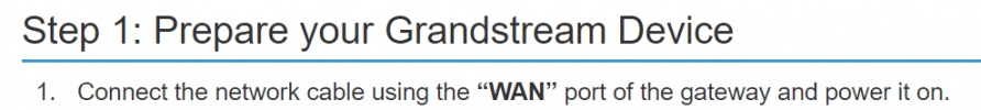

Hello Hernan,
If you cannot get the unit to get a DHCP address on your network there's no point trying to provision it yet. First ensure the networking is healthy.
Are you absolutely sure that you have followed the 3CX guide correctly and connected the cable on the WAN port?
Only thing that looks odd on the grandstream is that it does not get the gateway dhcp, it keeps 192... I tried with static IP, but still, no luck getting the configuration.
I have a feeling you may have connected it on the LAN port because you said are having issues with DHCP, something that would be expected if you connected the LAN instead of WAN port. This is also liable for bringing your entire network down, since you will be introducing a rogue DHCP server.

It is connected to the WAN port. I do get a valid IP from the DHCP server, and I can access the gateway via the http interface, but it does not get the DNS info from the DHCP server. I have to manually change the DNS server as it keeps 192.168... and my network is 10.10...
It might be some problem with the DNS server, which would prevent it from finding the provisioning server, but the network is definitely working OK, so it might be the gateway that is not able to get the proper DNS server information. Again, I tried setting up the IP manually, and still not working.
