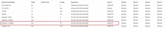

Sure, here's all the outbound rules.

Hi, I've updated the outbound rules and still experiencing this issue "Target Not Found". I have provided the outbound rules as well. There is a 10 Digit outbound where it should strip the 1st digit and replace with +61. As you can see, the outbound rule did not apply. I tried to apply the outbound rule to Conference (700) but I am unable to find the extension. I am guessing this is by design.
