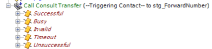

I'm designing a call flow script for our duty call engineers.
We store the cellphone numbers of our duty call engineers in a database.
In the CFD script, I check the database to see which engineer is on duty and then I transfer the call to the cellphone of that engineer. So far so good...
When the engineer does not pick up the call after 20 seconds, his voicemail is activated. I would like to set a timer on the transfer so that I can stop the transfer at 18 seconds and transfer the call again.
Is this possible?

We've been looking at the same question as well, but transfering using a call flow script is not a monitored transfer. So no luck there.

That is exactly the issue... I can't set a ring time on the transfer in CFD. I'm not calling a queue or ring group, I'm calling external numbers.
In Cisco, the transfer option is a Consult transfer, so we can monitor if the transfer is succesfull. It would be nice to have this in 3CX CFD as well...

Perhaps the biggest challenge is determining what answered the call. It could be a human, or it could be the mobile phone's voicemail box. Remember, if the agent's mobile phone dies in the middle of the night, or if the phone is currently outside a cellular service area (traveling between towers), you are going to be sent to the voicemail box immediately regardless of what you do.
The answer is to make a call between a CFD application and the agent's mobile phone so that when the call is answered, user-input is required. For example, "This is a call from VoIPTools On-Call Manager. To accept this call, press 1". The mobile voicemail box is not going to press 1. Further, a child is not likely to press 1 if they pick up Dad's mobile phone. Or you could require a PIN, which further eliminates the possibility of a unauthorized person interacting with the on-call system.
Perform a makecall between a CFD application and the agent. If the call does not go through, or the agent doesn't enter the PIN, then you log the call was not accepted and you escalate to the next person in the on-call list.
