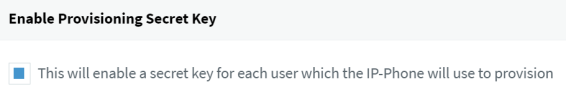

So if I remove a phone from user, it won't deny connection? Even though extra security is turned on?
I will test and report back.

No, the only thing that will deny an already provisioned, working phone from continuing to work is a change in the SIP auth credentials.
It won't get new updates / changes (like some names, new/removed BLFs, etc) if it can't talk to provisioning server, but it will continue to make and receive calls without any issues.
