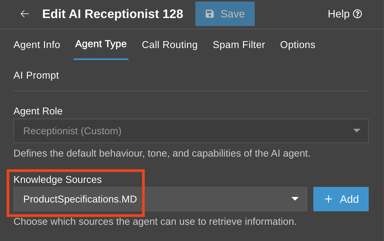

To avoid this, use Markdown (.md) files for your AI Agent knowledge sources.
Markdown keeps documents clean, structured and easy to read. It works well for people and it gives the AI Agent clearer content to search and retrieve from.

# Setting up AI Agent Knowledgebases
Cleaner knowledge sources help your AI Agent return better answers. Review your existing files, convert key documents to Markdown and check that headings, tables and metadata are clear before assigning them to an AI Agent.
