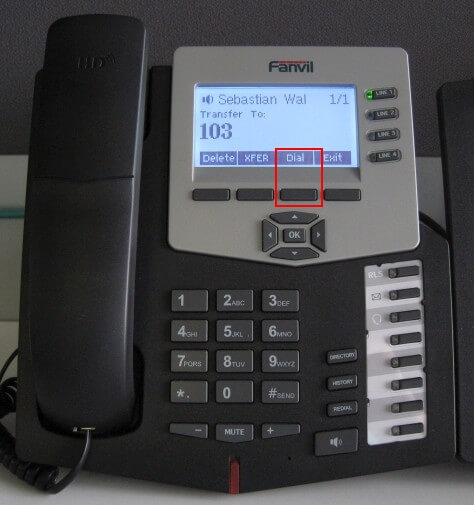

- Press the "Answer" soft key to answer an incoming call.
- Press the "XFER" soft key to start the attended transfer procedure. This will automatically put the caller on hold. Dial the extension number of the person you would like to transfer the call to. Press "Dial" to call.

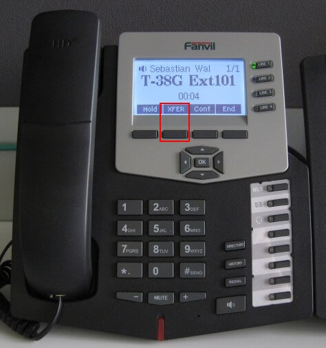

- The transfer recipient answers and accepts to take the call.
- Press the "XFER" soft key to transfer the call.
- The original caller and the transfer recipient are now connected.
