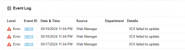

Just tried to upgrade a V18 latest update server to V20 Update 1 Release and this is the log that I get. If I read this correctly it has to do with the postgresql database either access to or from?
